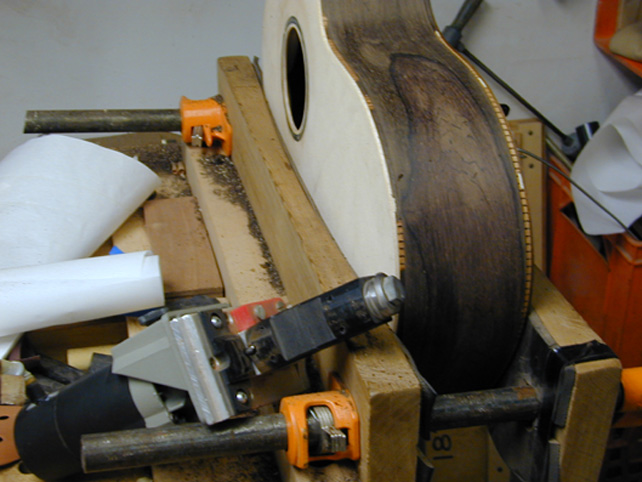

Here is mine - attached by a couple C clamps to the end of my vritas style bench - its there all the time now, I should just bolt it down. really simple, 2 pipe clamps, 2 2x6 of cedar radiused such that only the edges fo the guitar body are clamped, no presssure on the top or back. Cant be seen, but I added a blanket underneath to catch guitars not clamped firmly enough - has saved a couple. As well, thats my homemade binding ledge cutter attachment for the lam trimmer

Me too, like Sylvan's. Works very well with the binding jig that I use, modelled after Arnt Rian's somewhat like Tony's. I use 1/4" ply, which gives some flexibility, putting slight pressue on the top and back, but most around the edge, lined with carpet, with some green plastic light garden fence kind of stuff to catch anything that might fall through. Works great and cheap if you get the clamps from HF.
